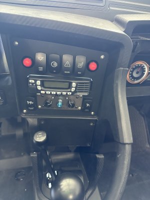

Here are some of my interior mods so far.
1) Replaced the intercom cable inputs with more switches. Not a fan of these rockers but only wanted white back light two match the others so options where limited.

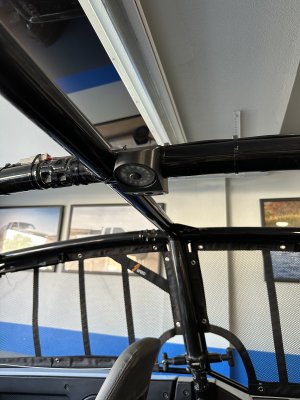

2) Added a 3d printed dome light that holds to KC Cyclones.

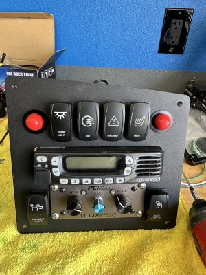

3) Swapped out the intercom for Trax and ran cables to each seat. Had to pull the skid plate to run cables down the floor tunnel.

@951prerun looking good!! Love the dome lights. Did PCI do the exchange/upgrade for the original system plus difference in cost? I was planning on doing that.

View attachment 1346View attachment 1347View attachment 1348
Great job. Car looks awesome. I intend to do the same mods with mine. I'm curious about your number 3 in your post. Was there no way to go under the center console as opposed to going under and removing the skid plate?

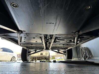

Yea only way to get in the center tunnel is via the skid plate, which was actually pretty easy.

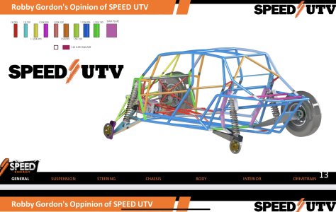

Does this legend still hold up? 1.125 for intrusion bars and 1.75 for main cage?

I want to clarify something from your post - do you have the stock skid plate or the thicker (optional) skid plate? My car will have the thicker option and I’m curious how that is attached to the car? I‘m hoping it’s a reusable screw and not rivets. Thanks again!

I have the thicker skid plate ( which is a must in my opinion) and it’s attached with bolts. The lower frame tubes are drilled and tapped.

Optioned the full skid plate as well since most of the riding will be out in Parker.
Probably take it off for glamis, but we wills see.
@951prerun how heavy are those skid plates?
