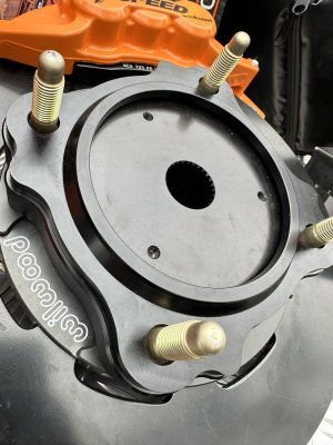

I talked to Method. They had some wheels on a Speed. They had no clue about the hub size and specs. So they basically have a wrong fitting wheel on the car. Yes it bolts up but it’s for sure not sitting the proper way. No way I’m having a failure while doing 50+ out in the dunes/dirt. This thing is significantly larger in diameter than a regular RZR and the tapper clearly calls for that on a wheel for proper seat and fitment.IMG_5337.jpeg

I talked to Method. They had some wheels on a Speed. They had no clue about the hub size and specs. So they basically have a wrong fitting wheel on the car. Yes it bolts up but it’s for sure not sitting the proper way. No way I’m having a failure while doing 50+ out in the dunes/dirt. This thing is significantly larger in diameter than a regular RZR and the tapper clearly calls for that on a wheel for proper seat and fitment.View attachment 2550
I have some packard ultralights I was planning on using. I will have to have someone machine them a little bit to make them fit perfect though. I wonder if they will make a small spacer to allow more wheel options. (not a fan of spacers but seems it would be pretty small to make the sit flush?
That's what I was looking at and thinking. Looks like a thin spacer that'll make the complete hub level would work but that would also be less of the wheels studs holding onto the rim.
I feel you on running spacers, but yes. That would definitely be an option. From the looks of the bolt length, Robbie didn’t leave much room for a spacer. Would require one with its own bolts built in.

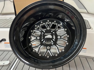

Are you talking about these wheels? I fell in love with them at the show. IMG_9643.jpegIMG_9642.jpeg

I have looked into that. Was thinking a 1/4 in aluminum spacer Do you know how deep that lip is ?

I am not sure how big the lip is yet. I know they said it in a video but i would rather wait to eitiher get the car or get a trusted measurment. I live in Mesa. I am a diablo so probably have several months before i am going to chat with him about it again.

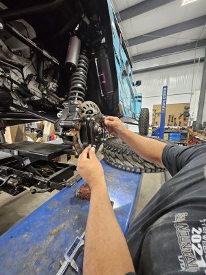

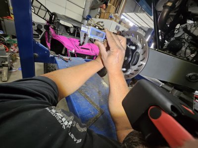

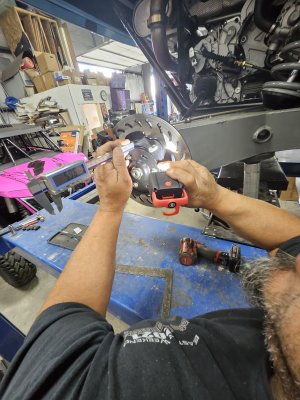

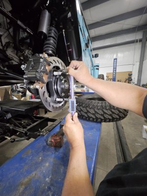

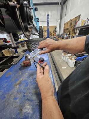

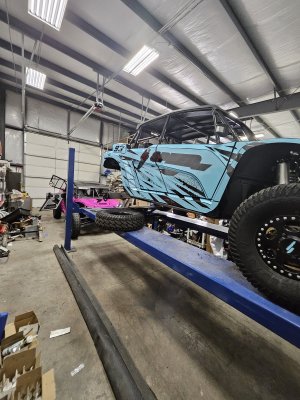

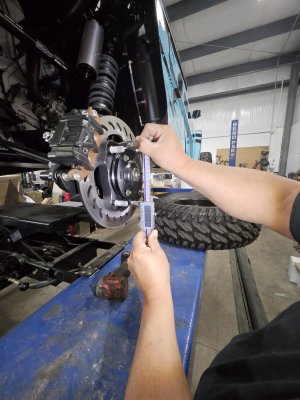

Took some pics and measurements for you guys. I went and grabbed a hostile hf11 wheel and tried it on the speed and it fits. It had I believe a 132mm center bore. That is the wheel im gonna run. There is a spacer on the car already.
Here you go!
