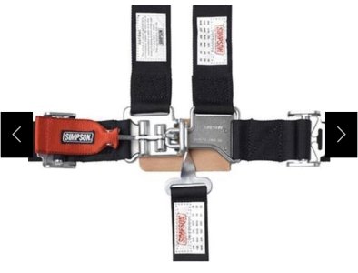

Here’s something most probably don’t know. Robby used to be a Simpson Safety supported driver. He wore and used all Simpson gear. When Simpson was looking to build a recreation off road seat belt they came up with the D3, and Robby was the poster boy for Simpson and the D3 belts as he’s the well known off road guy.
For those that don’t know the D3 used hardware vs sewn to intergraded the lap & shoulder belts, making it a single point buckle. I wonder if Robby ever thought of using this style of belt in the Speed? He knows about it, but who knows if they thought about it, or what the cost might have been as this is a Simpson Safety design.
Edit: also look at this picture and you can see by intergrading using hardware the shoulder straps are closer together putting the shoulder belts in a better position to not come off your shoulders.
Now look at that picture and imagine how much farther apart the shoulder straps are if you have to sew them in after the buckle and then moving the lap belt adjusters even farther down on the lap belt. The Simpson design is the best if you’re wanting a intergraded shoulder/lap belt.

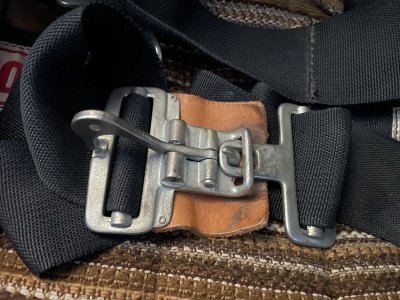

But still to this day I use Simpson and the preferred belt I like is the Latch F/X as it’s a 3 inch lap belt with intergraded adjusters built into the buckle hardware. No trying to pull down to tighten and having the seat slots get in the way. Or trying to reach between the seat or chassis & body. Grab the belt strap at the buckle and pull strait.
Here is the F/X belt. Look at how the adjuster is part of the latch. It can take some getting used to as it can be like wearing a rodeo belt buckle or something! But after a few rides you don’t notice it and I actually feel more supported.

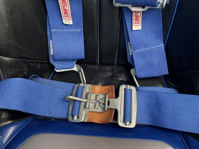

Here are pictures of the Simpson FX belts in my Baja bug Prerunner and RZR.

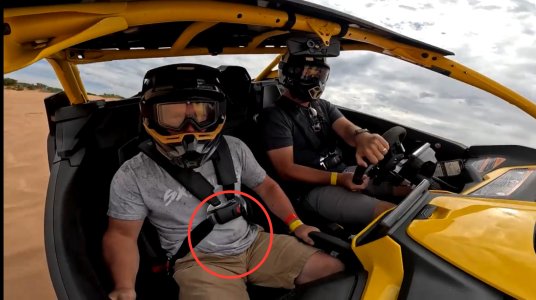

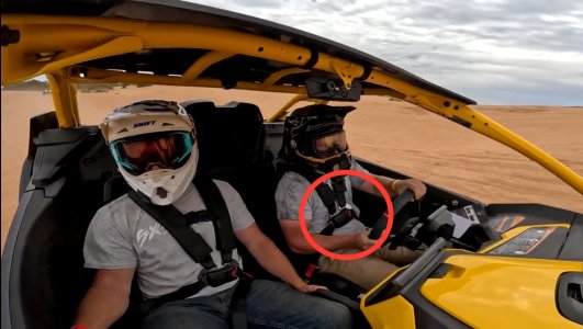

But during the video I took these screen shots of how they were wearing the stock seatbelts. I was shocked! I just don’t know if they don’t know how to properly wear a seatbelt, or what? But this is exactly how you never wear your seatbelts.
Remember your buckle is to be in your lap and straps you in at your waist. This is the #1 most important belt to have on. Then shoulders, and if set up properly should be snug but not pushing you down in the seat as that’s adding compression pressure to your spine. Then a crotch or submarine belt is to support the lap belt and keep it from rising, but to keep your body from being able to slide out from under the belts.
Please never let anyone ride in your cars without the belts properly adjusted. This is why they are adjustable.
Wrong! He’s wearing the lap like a sternum strap.
Wrong! Even the passenger should have it lower at his belt line.

Good catch, they know better….or they should. Look at all of the tragic stories shared on our Speed forum. They need to set a better example.
