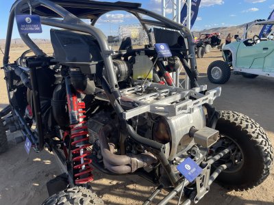

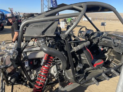

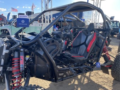

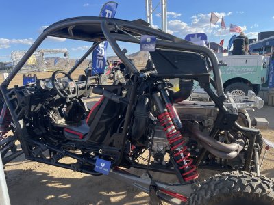

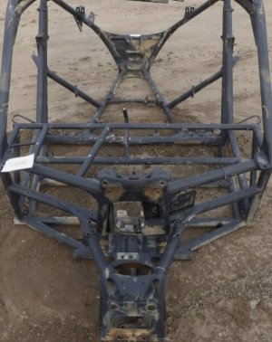

You should feel a lot safer look at this difference in a stock cage.

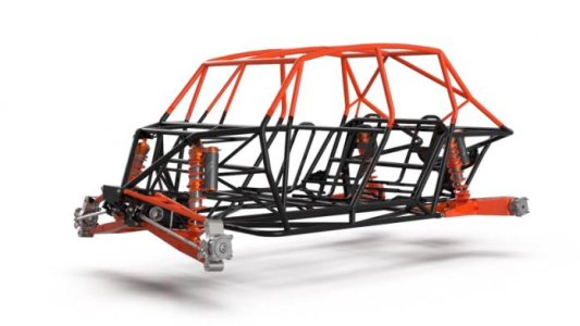

Looking at the Speed cage/chassis in post #7 and comparing that to the cages in posts #10 and #11, I know which cage/chassis I would rather be in if a crash occurs. The Speed cage/chassis has that "I was designed by an engineer" look. The other brands don't have that look in my opinion. Sure, the Speed cage/chassis weighs more, but for good reason. Robby and Daniel have always said that they designed the Speed cars with safety in mind. It sure looks that way when comparing the skeletons. :cool:
Wall thickness of the tubes also plays a role.

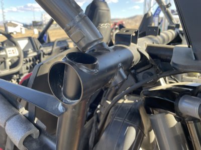

The problem with these cages is they are all bolted together. If Robby is shipping them fully assembled, I think they should be welded. They are bolted because it’s easier to ship. More compact.
This. It's also going to be a problem if you try and race them. Tech inspection doesn't like stock bolted roll cages. Norra will probably be fine since Robby owns it but don't expect to get into the Baja 1000 or KOH without some modifications.
Correct me if I'm wrong, but RG has stated at nauseam that the cage couplers would need to be welded up for racing purposes.
And I believe it should read 'Co Owner'
And NORRA has had looser standards before RGs co ownership.
Just saying.
Just saying.
☝️ This is correct
Just saying.
My point is if it was one piece then you wouldn't need to weld all the cage couplers to be race legal. They made the cage like that so they could stack 6 cars in a shipping container. If they aren't going to be doing that any more and sending whole cars I would rather have a 1 piece cage. I was agreeing with the post above me that I would rather have it welded too.
They would still need to add and weld door crossbars to be race legal as well.
