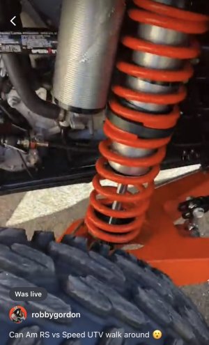

I thought it was best to have the spring ends 180° from each other to keep springs from binding and rubbing on the shock body. This car 18 during can am comparison.
These are going to be the things I feel everyone should be checking when they get their new cars. Every friend who’s got a new RZR, I always tell them to count & back out the shock compression clickers to see where they were set at, and then go back in 6-7 clicks to set the baseline. In several cases we had to clock springs, and in every case the clickers are all over the place. One wheel will be 4 clicks in, another 8, another 10 etc. I also measure spring adjusters on the shock body, and I’ve seen them within 1/2 inch off from right to left shocks.
Can Am’s typically are delivered sitting lower than correct ride hight. I believe the two reasons is packaging hight in the crates, but I’ve been told they needed to sit lower to pass the J turn test. I helped adjust a X3 and added 3 inches of hight, and the car worked so much better then how it was delivered.
So I think even with Speed, don’t assume your final assembly & QC will be perfect. Check everything like you are preparing on doing a 500 mile prerun or ride.
These are going to be the things I feel everyone should be checking when they get their new cars……….So I think even with Speed, don’t assume your final assembly & QC will be perfect.
On my XX, I had to adjust the springs as the fronts were rubbing on the shock body. Adjust the rear trailing arm alignment, kept losing rear axles. The doors weren’t aligned, they would bind once the sun would warm them up.
